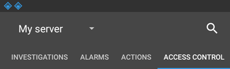

    1. Tap the ACCESS CONTROL tab.
    2. Tap Access control drop-down and select Access requests.
    3. Tap an access request to open it.
