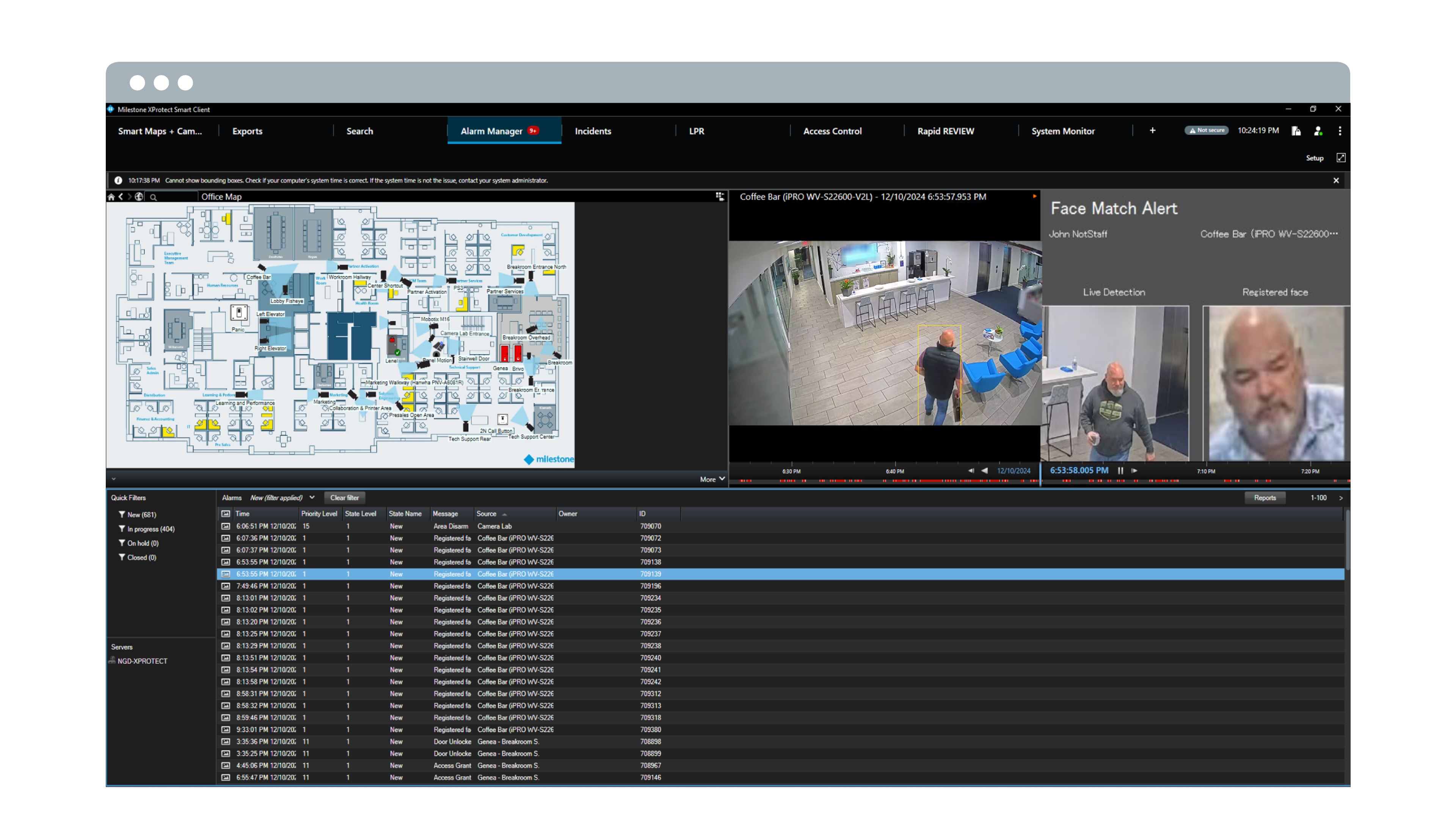

12. Stay proactive with the Alarm Manager
Imagine an intelligent system that automatically flags potential security threats and guides you toward a swift resolution. XProtect’s built-in Alarm Manager empowers you to do just that. The Alarm Manager tab presents a prioritized alarm list, equipped with versatile filtering and sorting options. Alongside the list, an alarm preview provides instant access to the footage associated with the selected alarm. This seamless integration streamlines your response to potential incidents, allowing for faster investigations and informed decision-making.
