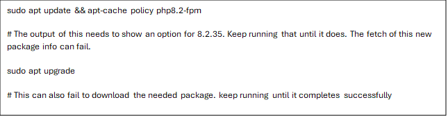

The Milestone Evidence Manager, an extension to XProtect, currently uses a vulnerable version of PHP. Milestone advises all users of Evidence Manager to upgrade their installation to PHP to version 8.2.35 using the following steps:
