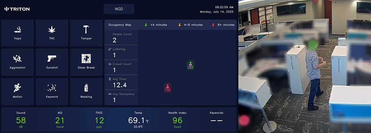

This approach is especially valuable in privacy-sensitive spaces where cameras cannot be installed. As shown below, Triton Sensors monitor activity inside the protected area, while XProtect provides nearby camera views that help operators understand what occurred before and after the event. If additional investigation is required, surrounding video can also be analyzed using video analytics tools such as BriefCam. Check out this webinar for more information.
Triton Sensors monitor activity and environmental conditions inside privacy-sensitive spaces where cameras cannot be installed, while XProtect provides nearby camera views to help operators verify incidents and understand what happened before and after an event.

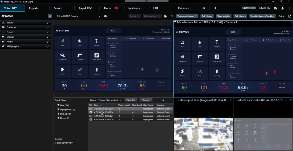

This demonstration shows how a HALO Smart Sensor detects a spoken emergency keyword and immediately generates an alarm in XProtect. Operators can review the alarm in Smart Client, view the sensor's location on a map and access nearby camera views to quickly verify the incident and coordinate an appropriate response.
