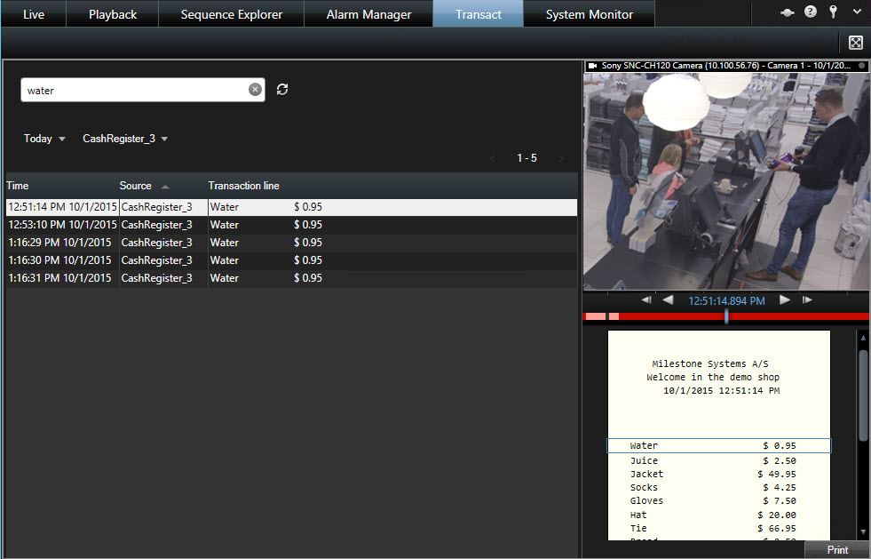

- Click the Transact tab.
- In the Today drop-down list, select a time interval.
- In the Source drop-down list, select the transaction sources you want to investigate. Disabled sources are marked with "()", for example "(CashRegister_)".
- Enter your search words. The search results are displayed as transaction lines below the filters, and in the receipt, the search item is highlighted.
- To update the list, click
. - Click a transaction line to view the associated video still frame. Use the
or
buttons to start the video in backward play or forward play mode.
