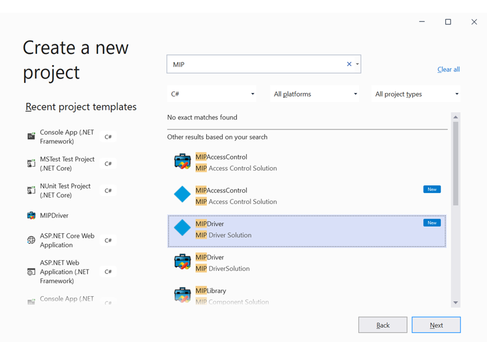

Use the new MIP Templates
Once these steps were followed, you are ready to get started! To create one of the above-mentioned solutions, you create a new project (File / New / Project…), then search for the MIP SDK Templates, and chose the Template that matches what you want to build. See underneath:
Please note, that in the above screenshot, the “classic” templates are still installed (which might also be your case).
The new MIP SDK Templates are recognizable by the blue Milestone “diamond”.
