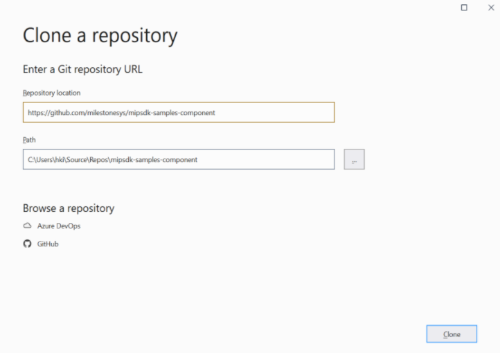

I wanted to work with MIP SDK Component Integration Samples, so I navigated to https://github.com/milestonesys/mipsdk-samples-component and clicked "Code" and then "Open" with Visual Studio.
Visual Studio now opens and propose a local path for the cloned repository:
Click Clone, and your local copy of the repository will be created.
