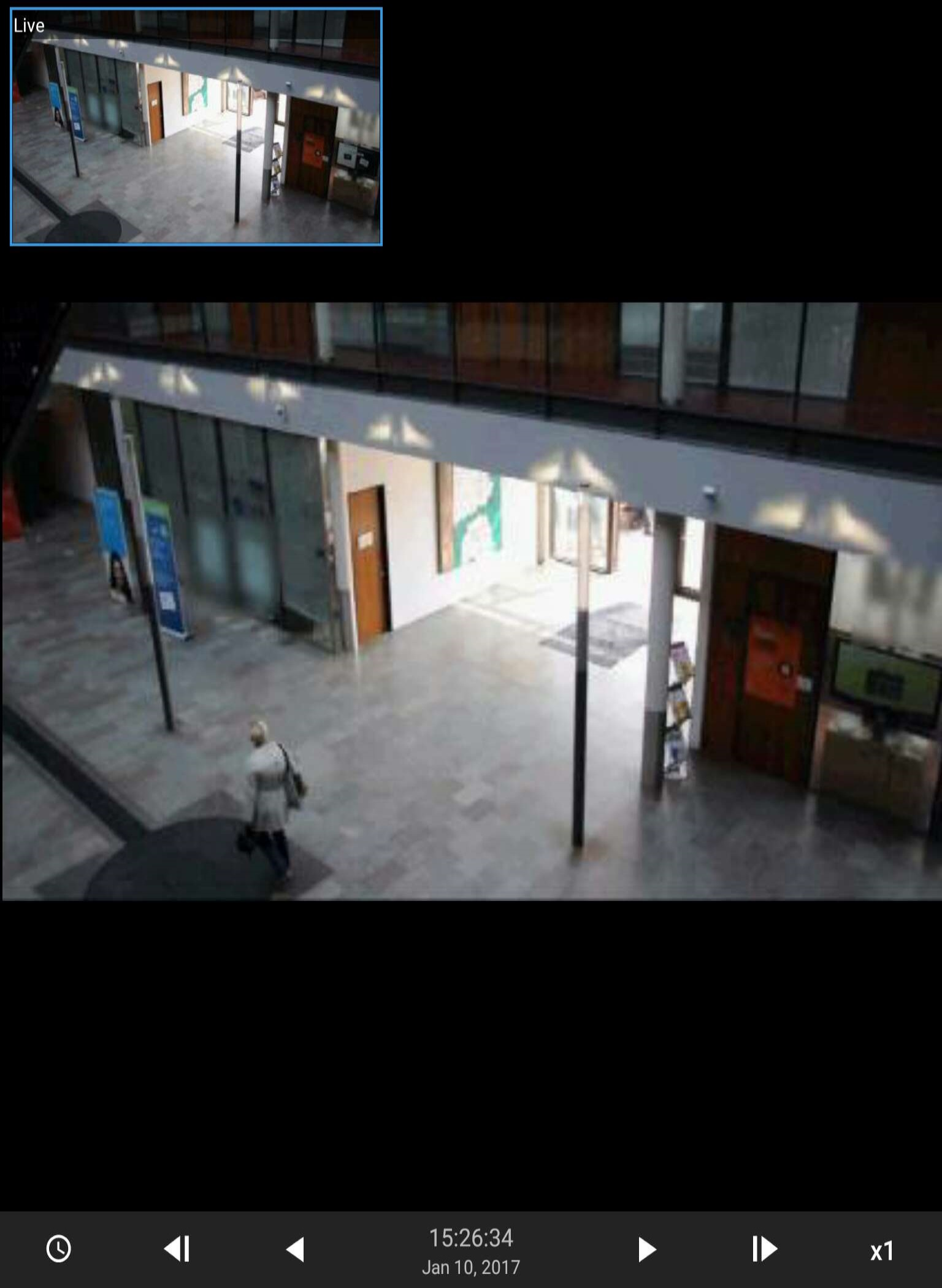

Use picture-in-picture
If you see something that you want to investigate, but don't want to stop observing the current situation, you can display the live video in picture-in-picture (PiP) and simultaneously play back the video.
PiP example
To turn on PiP:
1. While viewing live video from the camera, tap Playback icon Playback.
2. Depending on the operating system on your device, do one of the following:
  • Android - Tap Menu icon for Android, and then tap Hide/Show Live PiP
  • iOS - Tap Menu, and then tap Hide/Show Live PiP
Return to live video
 To view the live video in full screen, tap the PiP window.
